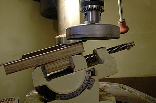

[QUOTE=John Mayes] FWIW my method of slotting using a cross sliding vise and a drill press
the spiral bits worked HORRIBLE for me. I could not get a clean cut. I
then tried a cheap Ace hardware straight cut bit and it was like magic...[/QUOTE] John, you mean a straight cut bit, but still in the cross sliding vise, right? I've been using this method (with the spiral bit) and get a small amount of chatter.

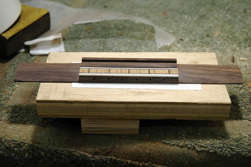

Hey everyone, why not post your pics of your bridge jigs, if you've got 'em?

Okay Roger, I will post some pics!
Here I am using a disk sander chucked into my drill press to sand the end bevels on my classical bridges.

[QUOTE=rlabbe] [QUOTE=John Mayes] FWIW my method of slotting
'em?
Yep a cross sliding vise but a straight bit, and shallow passes.. about
.040 at a time.
